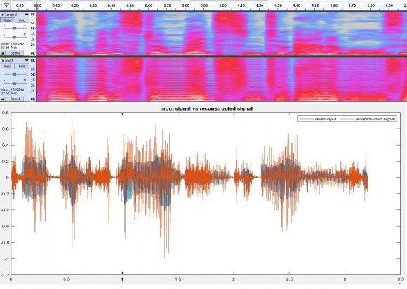

Hello, I am implementing a subband ADPCM codec, Fs=16 kHz, frame length 3ms, band1=50Hz-2kHz, band2= 2kHz-8kHz. I used the FIR filter for subband coding and %50 overlap. My reconstructed signal does not follow the input. why it happens (it perhaps due to the short frame but I don't know what is happening) and how can I fix it?

Reply by dgshaw6October 21, 2020
It is not easy to see from your plots, but there are clearly some repeating stripes in the lower spectral plot.
16e3 * 0.003 gives 48 samples per frame, but you say that they overlap by 50%, so my guess is that you have some discontinuity in the reconstruction that is giving you a multiple of 333... Hz distortion.
Reply by niloofar_omidiOctober 21, 2020
Thanks for your helpful answer. I made a mistake in programming. Now I fix it, but I should consider the critical sampling for these two non-uniform subbands. Since lower band is 1/4 of the bandwidth and higher band is 3/4, and it is impractical to decimate the higher band. However, 'demodulation' maybe help to do this and then decimate by the factor 3/4 as the low band.
