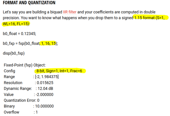

The displayed output in the example in section 'Format and Quantization' doesn't seem to match the object configuration. During instantiation the requested length is 16, with 15 fractional bits, but output of disp shows that the number is 8 bits long, with 6 fractional bits. Am I missing somethong?

Could you please send me an example of what you see to debug it?

Comment by piranha32August 6, 2026
This is what I see. If this is the correct output, I think it would be worth to add a line or two of explanation
Comment by ahmedshaheinAugust 7, 2026
This is what I get on my end:

Can you make sure that you have the latest release of the package?

Comment by remcyclesAugust 7, 2026
piranha32 is trying to point out an error in your published article, not a run-time error.
aha …
Thanks for clarification and pointing this out.
fix it.
