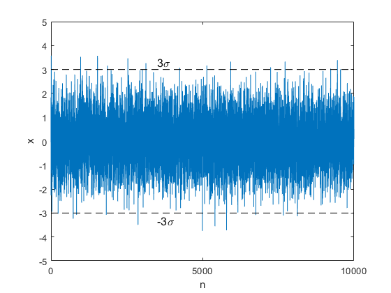

Figure 1.  Gaussian Sequence x of length 10,000.

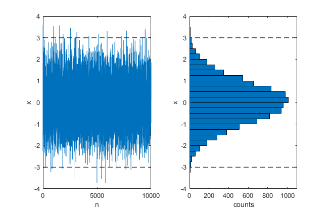

Figure 2 (left) shows the sequence x again.  Figure 2 (right) shows the same data plotted as a histogram, which has the same vertical axis as the left plot.  Horizontal bars show the number of samples that fall within amplitude ranges or “bins.”  These numbers are called bin counts or simply counts.  We see that the largest bin count occurs at x = 0, and the count is small for |x| > 3.
Figure 2.  Gaussian random sequence x (left) and its histogram (right).

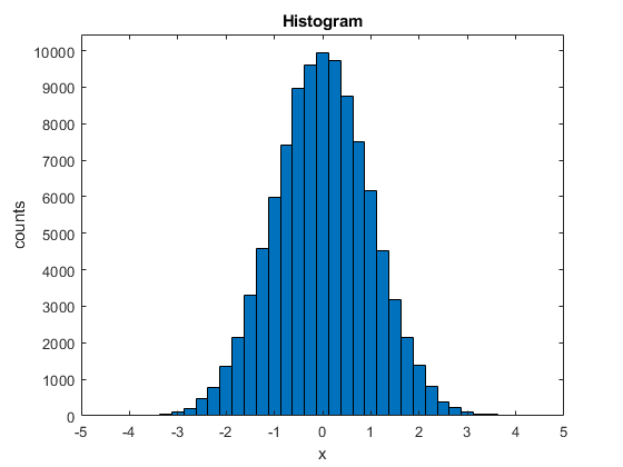

Let’s create a histogram for a Gaussian sequence with length N = 100E3.  This histogram is plotted in Figure 3, where we have assigned x to the horizontal axis and counts to the vertical axis.  The sequence x has continuous values, which we divide into bins of width 0.25.  For example, there is a bin centered at 0, with bin count of 9949.  Using narrower bins increases horizontal resolution, but causes more unwanted variation of the bin counts.
Figure 3 was created using the following Matlab code.  The short Matlab function pdf_plot graphs histograms and PDFs.  The function is listed in Appendix A.

Figure 3.  Histogram of Gaussian sequence, σ = 1, N = 100E3.

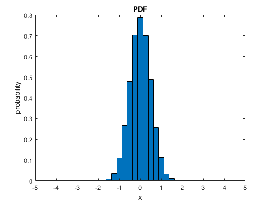

The Matlab Code of Example 2 also plots the PDF of the Gaussian sequence, as shown in Figure 4.  In this plot, the area of each bar is w*pdf(i), and the areas of all the bars sums to 1, as shown in Equation 7.

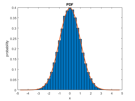

How well does our sequence’s PDF agree with the underlying Gaussian process?  The Gaussian PDF is given by:
$$ p(x) = \frac{1}{\sigma \sqrt{2\pi}}e^{{-(x-\mu})^2/2\sigma^2} \qquad (8) $$
Equation 8 with σ = 1 and μ = 0 is plotted as the red curve in Figure 5.  We see that, for N = 100E3, the PDF plot appears to agree well with equation 8, although the accuracy of the distribution’s tails is not visible.  (To see the tails clearly, we could plot using a semi-log y axis).
Figure 4.  PDF of Gaussian sequence, σ = 1, N = 100E3.
Figure 5.  PDF of Gaussian sequence, σ = 1, N = 100E3.  Red line plots Equation 8.
So far, all our sequences have had σ = 1.  If we instead use σ = 0.5, the amplitude of the x(n) is decreased by a factor of 2.  With N = 100E3, we get the PDF shown in Figure 6.  The smaller amplitude shows up as a narrower pdf, given that the x axis represents amplitude.

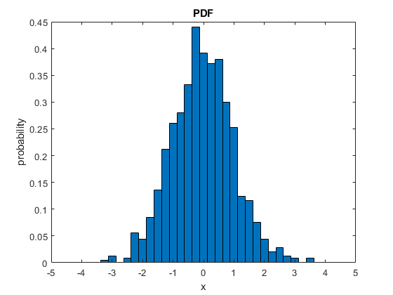

Finally, suppose our Gaussian sequence has σ = 1, but N = 1000, much shorter than the N = 100E3 used for Figure 4.  The resulting PDF is shown in Figure 7.  We see increased statistical noise in the PDF, which is quite significant in the tails of the distribution.  Note the empty bins centered at x = -2.75 and x = 3.25.
Figure 6.  PDF of Gaussian sequence, σ = 0.5, N = 100E3.
Figure 7.  PDF of Gaussian sequence, σ = 1, N = 1000.

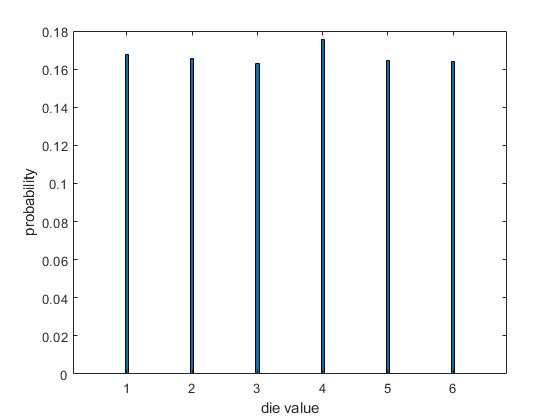

The following Matlab code simulates the roll of a single die and plots the PMF.  The Matlab function randi generates a sequence of uniform random integers over [1 6].  We find histogram counts for the sequence using the Matlab function histcounts and compute the PMF using Equation 9.
    rng(0)                      % set random number gererator seed
    N = 10000;                  % number of die rolls
    die = randi(6,1,N);         % vector of integers over [1 6]
    edges= .5:1:6.5;            % edges of histogram bins
    counts = histcounts(die,edges);    % vector of histogram counts
    pmf = counts/N;             % pmf vector from Equation 9
    % plot PMF
    x= 1:6;                     % horizontal axis of pmf
    bar(x,pmf,.05)
    xlabel('die value'),ylabel('probability')
The variable die contains the values of the die rolls.The first 16 values of die are:
    5 6 1 6 4 1 2 4 6 6 1 6 6 3 5 1
The PMF of die is plotted in Figure 8, where each outcome has probability of about 1/6 = 0.1667.
Figure 8.  Uniform PMF for rolling a single die, N = 10,000.

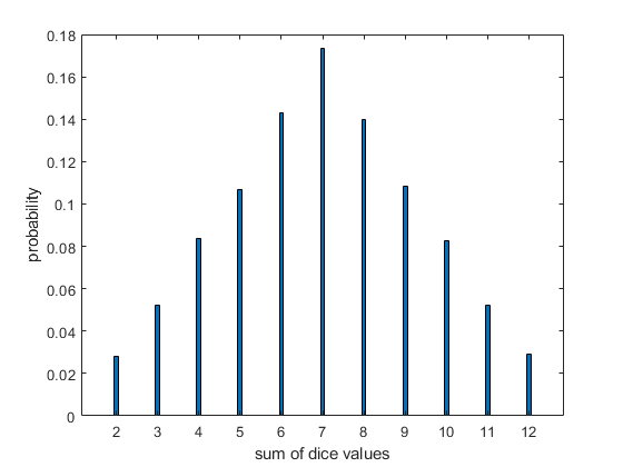

The result of rolling two dice is the sum of the values of the dice.  If we roll two dice multiple times, the resulting random sequence is the sum of the two random sequences of each die value.  Here is Matlab code to compute the result of rolling two dice (See Appendix B for the complete code).  Note that the sequences die1 and die2 are independent.

The PMF of y is plotted in Figure 9.  The probabilities fall between 1/36 (roll a 2 or a 12) and 6/36 (roll a 7).  The mean and variance of y, from Equations 1 and 2 are:
    mu =7.0018   variance =5.7422
The standard deviation is the square-root of variance:  σ = 2.3963.
Figure 9.  PMF of rolling two dice, N = 10,000.

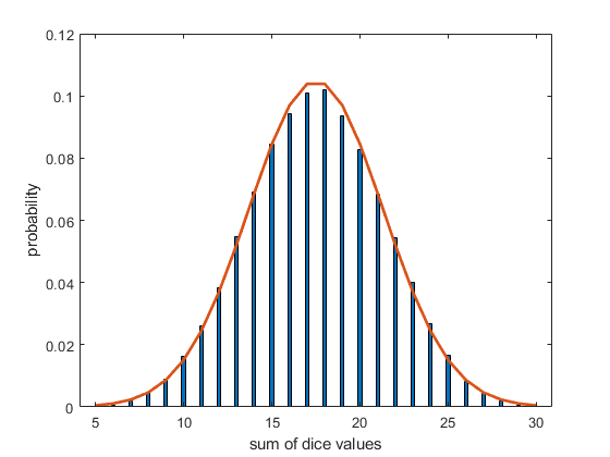

Example 6.  Illustrating The Central Limit Theorem
What happens if we roll five dice and sum the values of the dice?  The Matlab code for this case is listed in Appendix B.  The sum varies from 5 to 30.  The PMF is plotted in Figure 10, and it looks suspiciously Gaussian.  Calculating the mean and variance of this PMF yields:
    mu = 17.5020
    variance = 14.4949
If we calculate a Gaussian PDF (Equation 8) using these values, we get the solid curve shown in Figure 10.  This Gaussian PDF evaluated at integer values of x yields a pretty good fit to the simulation, except for the tail values of 5, 6, 29, and 30.  Also, the dice-roll PMF’s tail is truncated at 5 and 30, while the Gaussian PDF has infinite tails. The dice-roll PMF gets closer to Gaussian when there are more dice.
So, we have the remarkable result that adding several independent uniform random sequences results in an approximately Gaussian sequence.  This is an example of the Central Limit Theorem, which, in simple terms, states that the sum of independent random sequences having arbitrary probability distributions is approximately Gaussian.  Equivalently, if you sample a single sequence randomly to create M new sequences, then the sum of those sequences is approximately Gaussian [8].  One can start to see why the Gaussian distribution is ubiquitous.
Figure 10.  PMF of rolling five dice, N = 100E3.  Red line is a Gaussian PDF.
