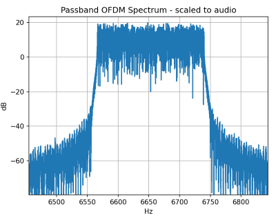

For example, the figure below shows the spectrum of a 1.6 ms long WiFi packet (PPDU) as a 160 MHz OFDM waveform centered on Channel 164 in the upper 5 GHz band (carrier = 5.815 GHz). When scaled to audio using wavelength-equivalent mapping, the carrier would be at 6.65 kHz with a corresponding 182 Hz of bandwidth.
In audio time, that same 1.6 ms RF packet stretches to over 23 minutes.
Here is what the first 10 seconds of that 22 minute packet sounds like:
160 MHz OFDM at 5.8 GHz, Sonified

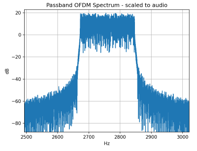

For comparison, I frequency translated the same 5.815 GHz waveform down to 2.412 GHz (the 2.4 GHz Wi-Fi band). While real 2.4 GHz Wi-Fi signals occupy less bandwidth, this hypothetical case illustrates what a 160 MHz OFDM signal would sound like at that carrier frequency scaled to audio with the same wavelength ratio. In this case, the carrier maps to 2.75 kHz with the same 182 Hz of bandwidth.
Here is the resulting sound file:
160 MHz OFDM at 2.4 GHz, Sonified
